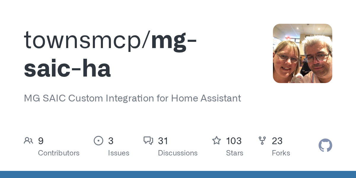

  • GitHub - townsmcp/mg-saic-ha: MG SAIC Custom Integration for Home Assistant
    MG SAIC Custom Integration for Home Assistant. Contribute to townsmcp/mg-saic-ha development by creating an account on GitHub.
    github.com
    Hier noch eine Alternative
